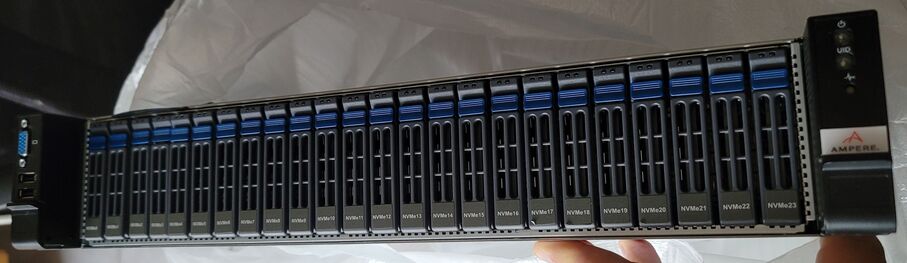

bero
The front side of the server has 24 2.5" NVMe U.2 SSD slots that can be hotplugged, as well as 2 USB ports and a VGA port.
If you are coming from the desktop or embedded world, don’t laugh — VGA ports are still very common (and useful) in the data center - many KVMs or video capture interfaces have not moved on to DisplayPort or HDMI.

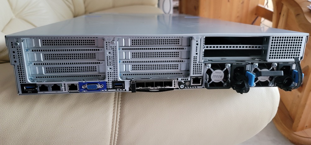

bero
On the back side, there are numerous network interfaces (for both the main machine and the BMC (Board Management Console - a networked interface that can control the main computer)), 2 more USB ports, a VGA port, an RJ45 plug for the BMC’s serial port, 2 PSUs (only one is needed, the other is a backup), and various slots for PCIe cards - so if we want to have fun and abuse the machine for something it was definitely not meant to do, we can plug in a PCIe graphics card, a PCIe sound card, and have way more cores in our gaming machine than all those Windows losers. ;)

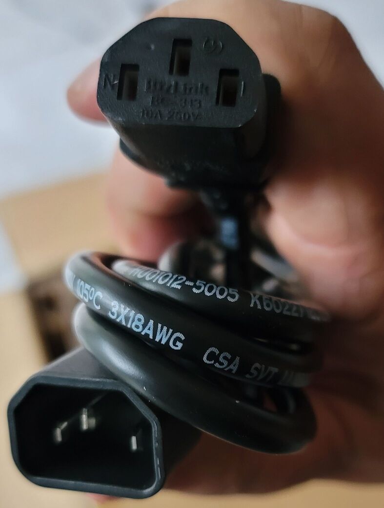

bero
Beyond the usual power plugs, the box also includes C-14 to C-13 power cords - very useful if you want to connect it to a power distribution unit so you can power-cycle it remotely if something goes wrong, or to a UPS that uses this type of plug.

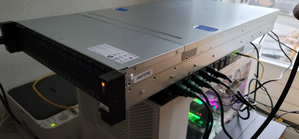

bero
It’s not like we can afford a professional 19“rack, but the box fits nicely into our infrastructure - below the Altra is the PDU and a network switch, and below that is C64 (no, not what you are thinking. Obviously that stands for”a Computer with 64 GB RAM"...), one of our main x86 builders.
The box boots up without problems - showing a very PC-BIOS-like firmware setup tool and a pretty standard BMC. It is preinstalled with CentOS Stream 8.
The PDU is not an accurate measuring tool for power consumption, but it gives a good indication: Power consumption went from 0.8A with C64, a RISC-V builder and a network switch connected to 1.5A - so the power consumption of this 160-core box is comparable to that of a 16-core Threadripper.
It takes 7 minutes and 4 seconds to boot to a point where the network is available though — and when restarting, further 6 minutes and 55 seconds to get back to the start (making a reboot take just below 14 minutes). While not a big problem (this is not the type of computer you reboot all the time), that should be something we can improve...

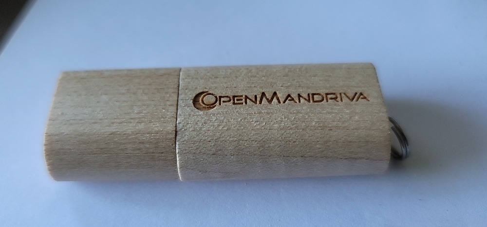

bero
So let’s see what happens if we just plug in an OpenMandriva USB stick and reboot...
Two pleasant surprises first — we didn’t have to make any modifications to boot on this machine, it can use the same aarch64 image as a much lower powered Synquacer or eMAG. And even when booting from the USB stick rather then the built-in high-speed NVMe, the boot process was comparably fast - down to 4 minutes and 52 seconds.
